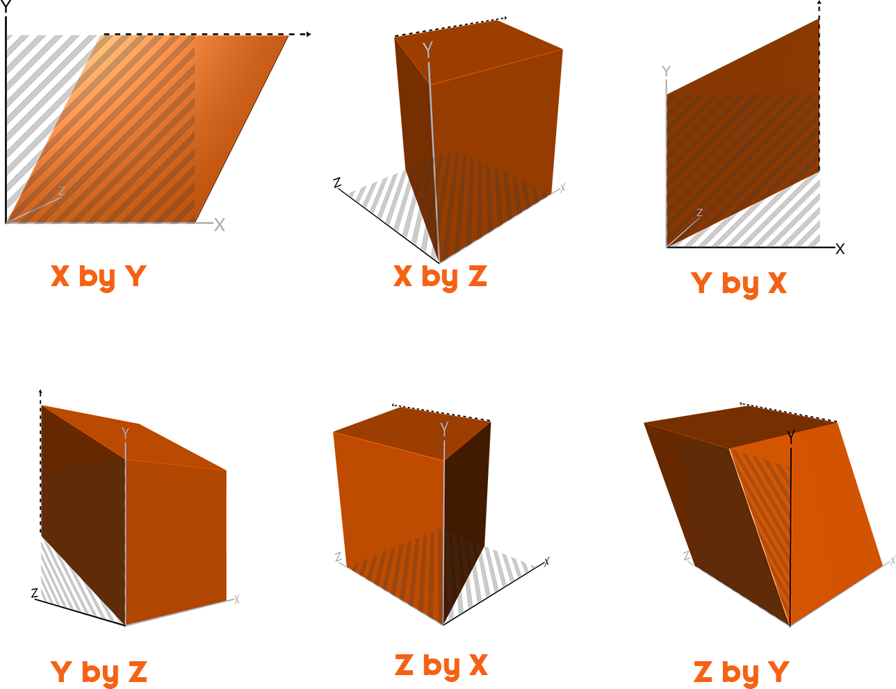

Shear
The Shear node is another specialized version of the Axis that allows you to deform single meshes or a complete subtree.
The Axis Property allows you to select the axis where the shearing is applied to. X by Y in that sense means the object is sheared along the X axis on the X-Y Plane. With the Amount Property the strenght of the transformation in percentage can be adjusted whereby an Amount of 100 results in an angle of 45 degrees.
This means the offset on the X-Axis is depending on the (signed) distance of each point to the origin of the Y Axis. The Amount defines the relation between the distance and the resulting offset. When set to 100% the offset will be the same as the distance and is also using the same direction (positive distance results in positive offset). The higher the amount the higher the offset. A negative amount results in a change of the direction of the shearing. See the below images for a visual reference.
