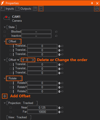

Offset a Camera Origin
Especially when working with Head Mounted Displays you will come to the point where you need to change the Camera origin to morph from one location in the scene to another. To so you can simply add Offsets to camera by clicking the Add Offset button.
An Offset allows you to translate the Camera by the TranslateX,Y,Z properties. The Rotate provides Rotate X,Y,Z to rotate the Camera.
The order of how the offsets are multiplied togther is defined by the order and can easily be changed by reordering the Property Groups.
Beside Translation and Rotation you can also use a Matrix to apply an Offset to your camera.
