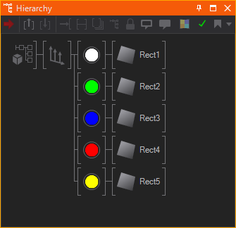

Same as without an Arrange Controller, the Arrange node will treat each of its children (and the subtree originating from them) as a separate entity. By setting the DataMode property to None, an Arrange Controller will only control the position, orientation and scale of each of those entities but not change any of the properties of the nodes themselves.
Layout
The Layout node in Non-DataMode arranges items automatically based on their size and content. This is very useful for text blocks or images embedded in text. Paragraphs could be separated in several single text elements which are layouted automatically. Changing the size of any element of the layout will re-arrange them immediately. This makes the Layout node very interesting for text elements containing dynamic images (smileys, logos, etc).
For the Layout controller to work, the Arrange node has to be set to LeftChain (Left-To-Right reading) or RightChain (Right-To-Left reading) for AlignmentX. Other layouts are not supported yet. AlignmentY and AlignmentZ are ignored.
The Width property of the Layout controller defines the available area to layout the elements where the ChainOffsetX is inserted between every element. If a line exceeds the available Width a line-break is inserted and the next line will start with an Y offset defined in ChainOffsetY.
Remember to set a ChainOffsetY, otherwise the line break will cause the new line to be drawn over the previous one!

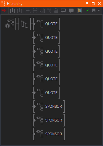

If the scene requires displaying multiple elements of the same type at the same time (a stock crawl usually displays multiple quotes within one line), multiple copies of the element have to be created and added as children of the arrange node. The Arrange Controller keeps track of which nodes are currently already in use and uses the child nodes as a pool from which it can temporarily acquire elements.
The name of the Container could be understood as the type of element. All instances of a type should provide exactly the same visual content as well as the same properties and functionality. A very comfortable way of maintaining copies of typed container is the usage of the Interface technology of Ventuz.
There's no control about which element is actually addressed. The Layout and Ticker nodes simply use the next available element. For the Ticker this means an available element which is not visible on screen (not already used).
Multiple elements are address by multiple XML elements in one XML text.
