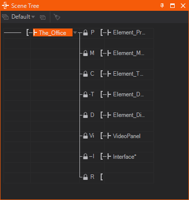

In terms of the limitation of the Community Edition Primary Nodes are counted through the whole currently active Scene Tree. Especially when working in the Ventuz Designer you need to keep in mind that not only the Nodes in the current Scene are counted. The node count of the currently open scene can be found in the scene tab, the node count of the whole scene tree is found in the System Information of the Performance Statistics.
Example
Below you can find a very common scene tree setup. One main scene loads and displays several sub-scenes. The limit exceedance depends on how many nodes each scene has. For the examples we assume a limit of 500 nodes:
  • Case 1 - The_Office and all seven sub-scenes each have 50 nodes: The limit is not exceeded as in sum they have 400 nodes.
  • Case 2 - The_Office and all seven sub-scenes each have 100 nodes: The limit is exceeded as in sum the scenes have 800 nodes, although each scene alone has less than the given limit.

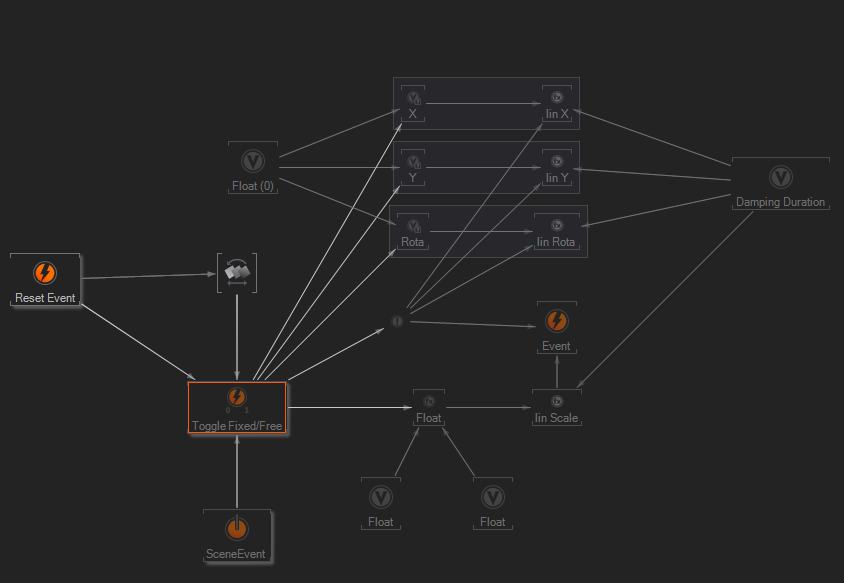

Each node has a number of Input Properties that are parameters which affect the nodes behavior (i.e. the size of a Rectangle or the speed a video is played). A node can also have a number of Output Properties that can be used to feed the input properties of other nodes. This is done via Bindings.
As long as an Input property is bound, it will update its value whenever the Output property of the bound node changes. For example, the X-Rotation property of a Axis node can be bound to a Mover node to continuously have objects under the Axis rotate around the X-axis. Binding of node properties is at the heart of Ventuz and allows the creation of very complex logic without having to program a single line of code.
Bindings are visualized as arrows which connect nodes in the Content Editor. To create a binding, select a node, go to the Properties Editor and drag the input property onto another node. When released, Ventuz will open up a list of compatible output properties of that second node. Upon choosing one of the properties, a connection is created and visualized by an arrow going from the output node to the input node. For more information, see Property Editor. When a node is selected its bindings will be highlighted as shown in the picture above.
For some nodes like the Keyframe Animation, dropping a property can have a different effect than just binding the property. For these nodes, drag the property to the target node and wait until the Property Editor switches to the new node. Continue dragging the property over the Outputs button, waiting and then releasing on the specific output property.
A binding can be removed by clicking on the arrow that represents the binding. A list of all bindings will appear and by clicking any of the crosses, the respective binding will be removed.

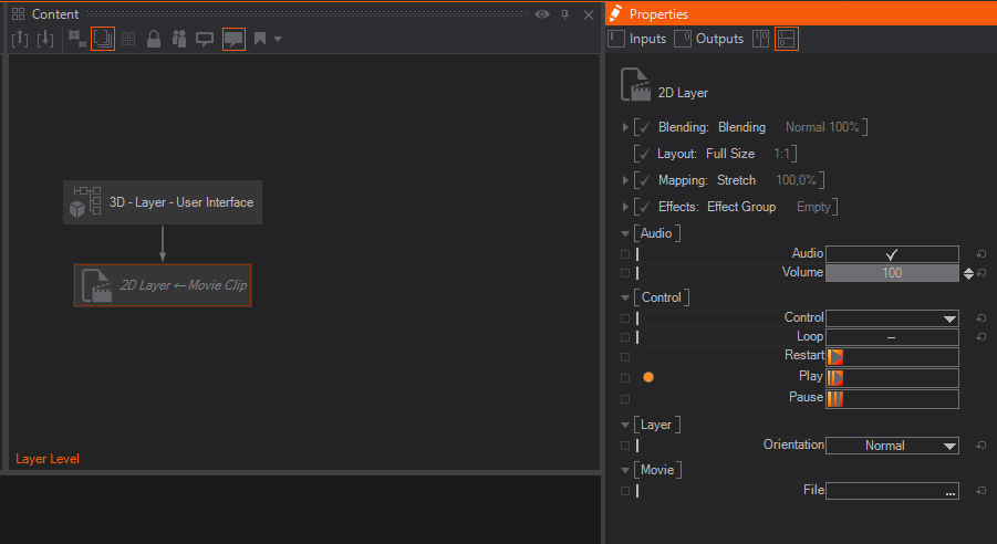

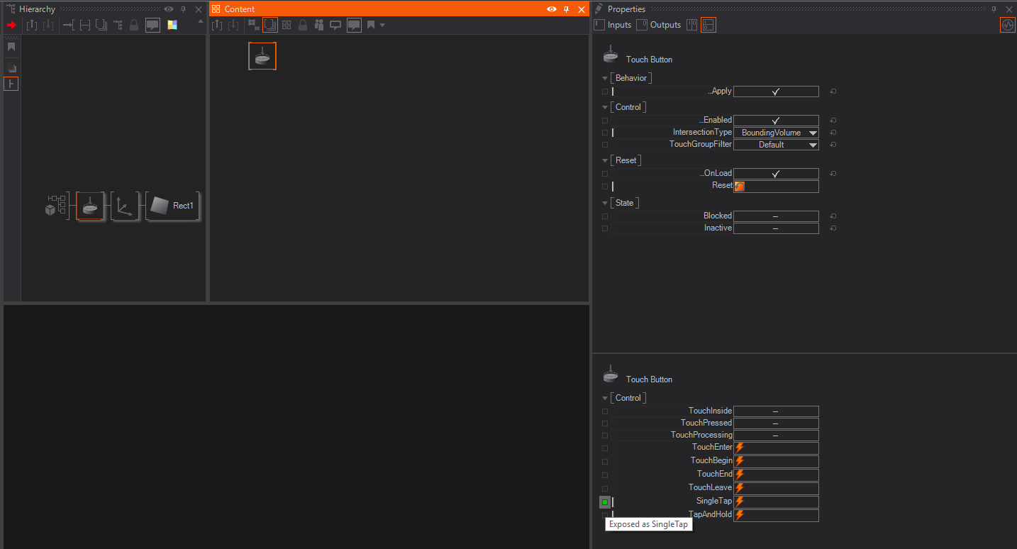

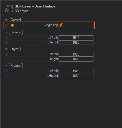

It is possible to have bindings across Layers. Before you can use a property and bind it from one to another layer, or bind the property to the Layer Level content nodes you have to expose the values up to the Layer Level. The following screenshots show a Touch Button which has the TouchPressed exposed from the 3d Layer (User interface) and is bound to the 2D Movie Clip Layer to control the Play.
Inside the Layer3D - exposed the SingleTap
Layer Level - The exposed SingleTap is visible and can be bound
The Play event from the 2D Movie Clip Layer is bound to the SingleTap
