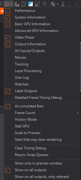

Statistics Options
The performance statistics contain a lot of information. In many cases displaying it all can be a bit overwhelming and requires a lot of screen real-estate. So individual sections can be enabled and disabled and with the Frame Count the amount of visible frames can be adjusted.
The display is updated every frame. By pressing the pause key, the update of all sections can be paused.

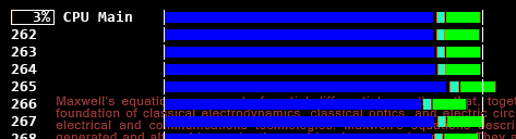

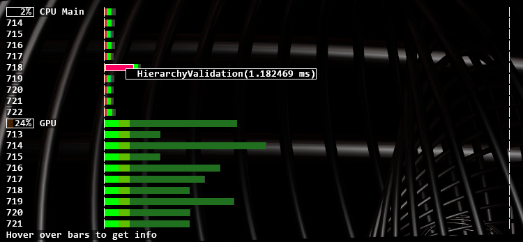

Performance
Here is an explanation of these sections.
This gives a detailed breakdown of what happens on the main CPU thread and the GPU. If SDI boards or Webcams are in use, it will also display the timing of the Video IO thread.
The percentages are averaged over the last 64 frames. The colored bars show in more detail which part of Ventuz is performing worst. By hovering over the bars, a tool-tip explains what the bars stand for. The vertical white lines represent frames. The display is configured to show two frames, assuming you are most interested in performance when things are bad.
Please note that the performance statistics are about frames, not fields. So when running at 1080i50, expect a framerate of 25Hz, and the bars show information about rendering two fields. This is especially interesting for the video engine, as it does most of its work per frame and not per field.
In general:
  • White bars represent the designer user interface. Switch off the monitor buttons in the property and layer view to reduce this.
  • Green bars represent rendering (on CPU and GPU)
  • Red bars represent validation (on CPU)
  • Cyan bars represent resource generators (on CPU mostly)
  • Yellow/Orange bars represent layers / post-processing
  • Blue bars represent idle time (only displayed when "accumulated bars" is switched off, see below)
  • The video engine thread does not follow this color scheme.
By default, bars for two frames are displayed. If the scene runs slower than two frames, the bars are truncated. To display more or less then two frames, the number of frames can be changed with the FrameCount setting in the performance pull-down menu.

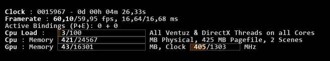

System Information
Clock is the internal cluster-synchronized clock of Ventuz. It counts video frames, or fields when in interlaced mode. This line also shows the Cluster clock converted into seconds, minutes, hours and days. Then follows the Cluster ID of this machine, and the Machine ID from which the clock is taken (in a cluster).
The last few numbers count the frames that were skipped or duplicated because of cluster synchronization, and the reason for the last skipping or duplication.
Framerate is the frame-rate and frame duration, accumulated over the last 64 frames (or fields). Again, in interlaced mode this is the rate of full frames with two fields. It shows the actual measured frame-rate and the expected frame-rate. This information is displayed again, converted into milliseconds.
When tweaking performance, think in milliseconds, not fps. You can easily do math in milliseconds, like 3ms + 7ms = 10ms. You can't do that with FPS. 333fps + 143 fps = 100 fps? That's correct, the same numbers as above, but it just doesn't make sense. Also, getting from 40 fps to 50 fps is 5ms, getting from 50 to 60 is 3.3 ms. Squeezing a millisecond is always the same, a difference in fps is essentially meaningless.
Active Bindings (P+E) shows the number of validated bindings of each frame. The first number shows property bindings and the second one shows event bindings.
CPU Load Tells the total CPU load by the Ventuz process. The Performance Timing bars above only capture the main thread and the video thread. The most important other threads are:
  • The DirectX driver usually spawns multiple threads that can not be monitored directly.
  • Movie playback creates at least one thread per Movie, and may be many more if the codec supports multi-threading (which it usually does).
The Scenes count behind the CPU Load simply indicates how many scenes are currently loaded into memory.
CPU Memory shows the percentage of physical memory Ventuz takes up, and how much memory is swapped on disk. The values come directly from the operating system, so they include memory that is allocated indirectly, for instance by DirectX.
GPU Memory shows the percentage of GPU memory Ventuz uses. The values are counted manually by Ventuz whenever it creates or destroys a resource. Since the driver may have some overhead that is not knowable to Ventuz, the actual amount of GPU memory used may be larger.
For instance, the driver may need to round up the width of a texture to the next power of two, so a 640 pixel wide texture gets rounded to 1024, a substantial difference. Ventuz can not know this and reports the incorrect amount. The Clock shows the current core frequency as well as the base frequency.
Note that the GPU Clock field shows the frequency of the core not that of the memory. It can go beyond 100% when overclocking the GPU.
Further information on the GPU can be found as well: The manufacturer as well as the model name, its core number and its core group granularity is diplayed right below the memory usage bars.
GPU: Indices is the number of Vertices drawn ignoring reuse. Each triangle contributes 3 indices, each line only 2. DrawCalls are the number of times something is drawn. With font rendering, multiple draw calls can be combined to a batch. The number of Batches is the most important indicator on how much time is spend in the graphics driver. Another trick used by font rendering to reduce the number of batches is Instancing.

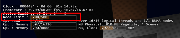

Node Limit
In the Community Edition of Ventuz you will find an additional Node Limit in this list. It indicates the currently rendered Primary Nodes and their maximum allowed number.

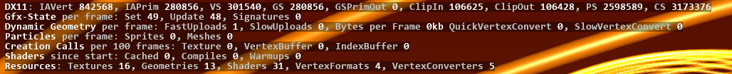

GPU Advanced Statistics
Gfx-State: Each material is represented as a gfx-state when it is actually drawn. Each frame the states are set and possibly need an update. Updating is especially expensive if the shader-signature has changed and the exact shader variant has to be determined. this gets even more expensive if the shader is new and needs to be compiled. You should make sure your Signature values are near 0 and Compiles are always 0.
Dynamic Geometry: Ventuz will do some FastUploads for internal purposes. When a geometry is animated by binding it, this will issue a SlowUpload when a value changes. How slow such an update is depends on how complex the vertex format is: Most vertex formats will undergo no conversion or a QuickVertexConvert. Sometimes a SlowVertexConvert has to be done, this should be avoided on animated geometries.
Particles: Shows how much particles, either as a sprite or mesh, are calculated every frame. High numbers can impact the performance of your scene drastically. Generally speaking meshes are impacting performance more then sprites.
Creation Calls: Are an exceptionally expensive part of the DirectX API and should only happen during scene loading.
Shader: Shows the currently cached and compiled shader number.
Persistent Resources: are resources that accumulate and are never deleted until Ventuz is quit. VertexFormats and VertexConverters are cheap internal resources that should stay below 25. Shaders is the number of different shaders that have been used since Ventuz started.

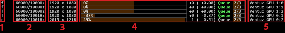

The Video Phase will give you detailed information about the health of all current outputs.
1: The first letter code indicates what Ventuz has set:
  • 'w' floating window
  • 'f' fullscreeen desktop rate
  • 'X' fullscreen exclusive
  • 's' swap sync
  • 'o' sdi / ndi / other (that dont have a window)
  • 'r' preview window
Everything after that will show in which mode it is in.
  • fse : (good) full screen exclusive - "real" fullscreen
  • fso : (good) full screen optimizations - borderless window promoted to fullscreen
  • dwm : (bad) display window manager - composition. synchroneity not guaranteed
  • blt : (bad) some other path
The following situations will always be "dwm" and should not be considered a problem:
  • floating window outputs
  • runtime preview window
  • designer preview window, unless switched to fullscreen (which will be of the fso kind).
2: Shows the current framerate the Output is using in Hertz.
3: Currently rendered resolution of that output.
4: Shows the phasing and Que of the Output: The orange bar shows the shift of frames till 50% after that it will show it in whole frames.
The number after it and in brackets shows the whole shift in frames.
Queues are represented in different colors depending on there sync status:
  • Green = queue has the optimal number of frames
  • Red = Queue is buffering too many or too few frames - there might be a frame offset on the output
  • Gray = optimal number of frames not available. This information is only available for fullscreen modes and certain SDI vendors(Deltacast and Blackmagic). For instance it is not available for NDI streams.

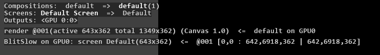

Output Information
Composition: Shows the currently rendered Composition.
Screens: Currently rendered Screen(s).
Outputs: Used GPU's for the current rendering.
Render: Shows the current number of render steps more complex scenes will show a higher number.
  • Active: Shows the currently rendered resolution.
  • Total: The size of the renderer window which could be rendered.
These resolution numbers will be bound to your Render Setup when using only the Runtime, previewing the "Design Preview or enabling "Screens and Outputs without Scaling". Only the other previews inside the Designer are dynamically changing it to save performance!
Blitslow/Blitfast:
  • Blitfast copies the whole screen 1:1
  • Blitslow can cut parts of the source and copies to parts of the destination, potentially with scaling and rotation, therefore slower. Slow does not mean really slow, it just means a bit slower.

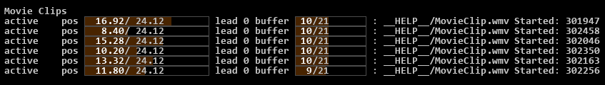

Movies
For each enabled movie related node, this shows information about the movie. This is especially important since most of the CPU load done by movies is not captured in the performance timing bars.
For each movie, the state, position, lead, buffering and file-name is shown.
The states are:
  • error: the stream failed
  • busy: Internal operation
  • empty: No file was loaded
  • loadmeta: loading metadata
  • loadinfo: prepare playback
  • active: normal playback
  • pause: playback is paused
  • seek: seeking
  • waitstream: for Movie Stream nodes, waiting for a stream to receive
When multiple scenes are load into Ventuz, all the inactive scenes have still their audio player initalized. This may waste lots of GPU and CPU memory for the frame-buffers. Movies from inactive scenes have gray text instead of white. Ventuz will automatically take care to put movie clips from inactive scenes into pause mode, so that at least no effort is wasted in decoding frames that are never displayed.
The lead works like this: When the clip is not in async mode, and Ventuz runs in a cluster, it can happen that seeking to a position is not good enough because when the seek is complete, time has passed and the video is already too late. To avoid this problem, always pause the video, seek, wait a bit and then un-pause. If this is not done, Ventuz will notice the problem and automatically seek to a position slightly in the future, like when shooting skeet. A lead of 0 means no problem, 1 means that Ventuz considers leading but hasn't done it already, and higher numbers indicate increasing amounts of lead-time.
The buffers show how many buffers Ventuz has allocated and how many frames in the future are available. If these buffers run dry, increase the number of buffers for that movie. At the end of each line you can see the exact Cluster Clock when each Movie Started. Like the lead this is mainly useful to check syncronization of movies in a cluster.
In the Ventuz Designer, one can jump directly to a movie node by right-clicking on the name of a movie. A message is displayed to hint this:
Here the top movie is in an inactive scene (therefore it is displayed in gray, by right-clicking on it one can see where the node is hidden.

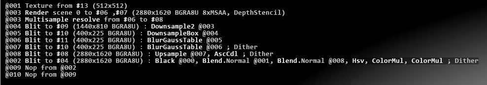

Layer Processing
The layer engine will magically convert your layering into an optimized set of shaders. Each shader call can blend up to 8 layers together, if conditions are right.
To check how well the engine does in combining effects into single shaders, you can look ad the layer processing.
Each line represents:
  • rendering a scene
  • doing a multisample resolve after rendering a scene, if multisampling is enabled. This converts the multisampled rendertarget into a single-sampled texture that can be used by a shader.
  • making a texture available for layer-blending (this is for free)
  • doing a blit, using a shader.
  • nop, no operation, a leftover from merging two blits together.
The log will reference textures and rendertargets with !#00, where 00 is replaced by a number assigned to the texture / rendertarget. Blits reference their sources by referencing to other lines in the log, using the notation @000. In the example you can see how a scene is rendered to color buffer !#06 and depth buffer !#07, then the color buffer is resolved to !#08 and the whole thing is referenced as line @003 in the first blit.
Some effect will create only a small shader snipped in one of the blits, like the grayscale and the color correct effect. Other effects, like the blur, will create multiple shaders, even changing depending on parameters. In the example above, the two downsample and the two blur blits are generated by a blur effect
Layer Blending will create Blend.XXXX blits, with XXXX being the blend-mode. The last blit line shows how multiple blends and other effects are merged into a single blit, the two nops being leftovers from the merge process.
As a rule of thumb: the less blits the better, and everything with blur in the name and the downsample box are especially expensive.

History Mode and Pause
To see spikes in performance better, enable the History Mode with the drop-down box. Pressing the pause key on keyboard will pause and continue the update of the bars. When the history mode is on and pause mode is on, use the page-up and page-down keys to scroll. Pressing the control key will scroll faster.
The numbers before the lines are the last three digits of the cluster clock

Stats that may slow rendering
These statistics are gathered in a separate thread so not to harm rendering performance directly, but there can be side effects that effect system performance that are hard to pin down. These stats will also show the current sync board status if one is configured and detected.
The sync board status is only available for NVIDIA Sync boards!
Clear Timing Debug
Clears the history of the Detailed frame time debugging.
Resync Swap Queues
Use this button when the rendering gets out of sync, to force Ventuz trying to resync everything.
Per Output Stats
Define where and what kind of information should be displayed.
Show on all Outputs:
  • Show information about everything configured on all outputs
Show only in preview window:
  • Shows all configured information only on the Preview Window
Show on all outputs, only relevant:
  • Only shows information corresponding to that output on that output

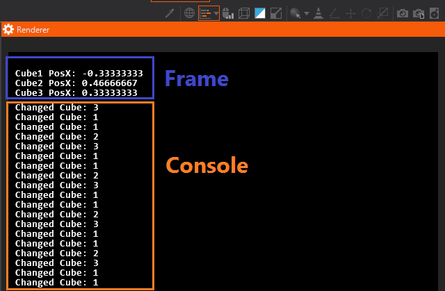

Logging
The performance monitor allows high performance logging. This is divided in two sections: Frame logging is replaced every frame, and can be used for watching values as they changed. This will look like the other performance statistics.
The console will work like a normal log file where messages printed will scroll endlessly. This is useful to capture events and state changes.
Use the Log Node or scripts to do frame and console logging.
Markup in Logging
The strings [sb:10/100], [mb:10/100], [lb:10/100] will paint a small, medium or long bar which will be filled for 10 of 100 parts (10 %). This bar looks like the Memory bars in the System Information section. The numbers will be printed as written, and the bar-length will be calculated by the division. So 33/100 will yield approximately the same bar-length as 1/3, but display different numbers.
To add text inside the bar, put it after the numbers : [lb:10/100MB]. A special mode allows number from -100 to 0 be displayed as decibel : [lb:-12/dB].
[! will print text brighter until ] is encountered, line in dim [! bright] dim.
The text-color can be changed with [tc:rgb] and [tc:rrggbb], where r, g and b must be replaced by web-style hex-colors. Again, the text in the brackets will be effected. Example: white [tc:ff0000 red] white.
When logging, c# will convert \n to linefeed (ASCII 10) and \f to formfeed (ASCII 12). Linefeeds will work normally, no \r carriage return (ASCII 13) is needed. Formfeeds will insert a half-sized linefeed. This is used between the sections of the performance statistics.
The codes \\, \[ and \] are parsed by the logging system and can be used for escaping. Other uses of the backslash will print the backslash normally. So in a c# script, one can write \\[ to escape a [.
When getting clever with markup, it might be a good idea to check in the render window and the web interface if both sides interpret the markup correctly.

Monitoring Movie Playback Performance
The movie playback does not show on the Main Thread. But it shows in the following way:
  • The CPU percentage includes all video decoding.
  • The status of each movie player can be displayed. Check if there are more active movie players than expected, or if movie players are switched on and off unnecessarily.
  • Transfering the image from the CPU where it is decoded to the GPU and performing the color space conversion takes some time on the GPU, displayed as dark-green bar in the performance timing.
When playing low frame-rate video (24 or 30 fps) on full frame-rate outputs (50 or 60 fps), the GPU processing is not performed every frame. Turning on the History option for the performance timing reveals this: The GPU processing is done only every second or third frame. Be aware that while the average GPU load may be below 100%, individual frames may spike beyond the 100% mark.
