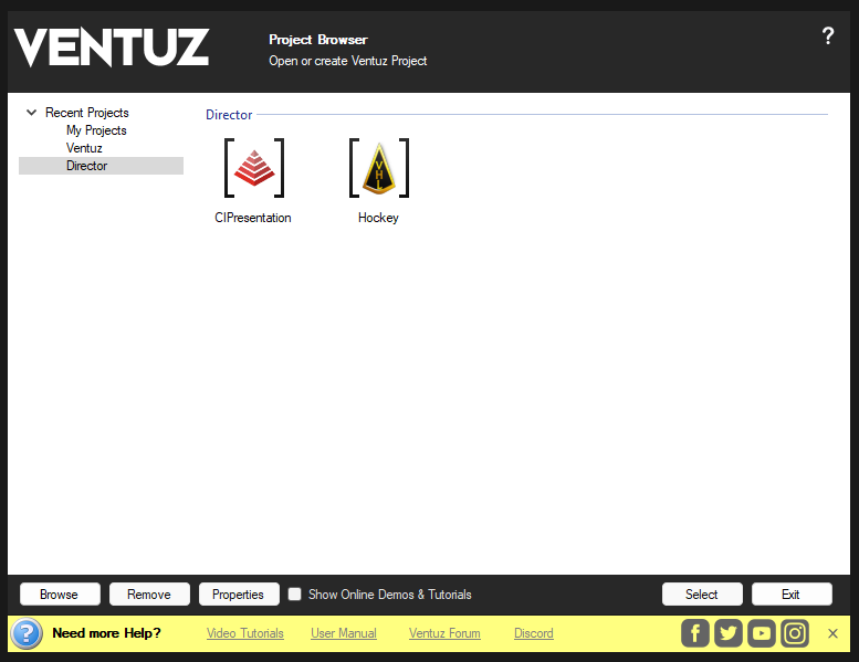

Upon starting Ventuz, the Project Browser will appear as the very first thing:

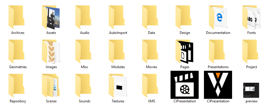

A Project is a collection of assets such as images, audio files, geometries, scenes, and a single project file with the extension .vzp. The assets are grouped into different folders based on the type of asset and are all located in the main project folder. If an asset outside of the project is used in a scene, it will be imported, or automatically copied into the project unless it is specifically marked as an external reference.
As an example, in a conference with multiple speakers or topics, each scene will be used for a single presentation but all of the presentations will use the same font, background, videos, etc. Hosting the assets inside the project instead of the scene allows for reuse and thus saves both disk space and memory.
Another way to think of a project is as a working folder. Instead of searching for specific images from various folders on the computer's hard disk, they are imported into the project and thus everything relevant is in one place. A project folder can be compressed and moved to another computer without compromising integrity as scenes only reference assets within the project folder (unless specifically told not to).

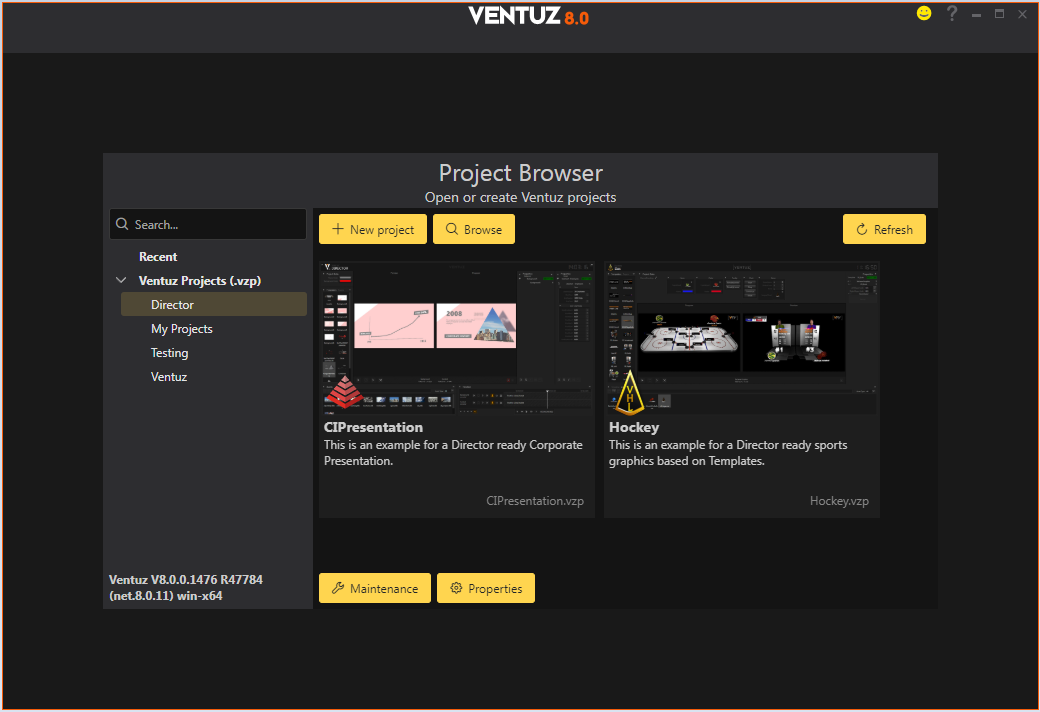

Select New Project from the Project Browser to open the Create Project Wizard. Choose a name and icon for your project, the aspect ratio of your target display, the location of the project folder on your hard disk and additional information like a description. Click Finish and Ventuz will create, initialize and open the project as well as a new empty scene.
The settings entered in the New Project wizard are stored in the Project Properties. To view or modify these and further settings, click on the Project Button in the top left corner.
Once a Project is opened, Ventuz switches from the Project Browser to the standard user interface. For more information on the specific windows, see User Interface.

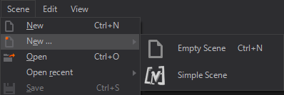

  • The second way is to use the Create Scene Dialog by selecting New... from the Scene Menu or by clicking Create Scene in one of the Editors when no scene is open. The dialog will ask for the type of scene to be created. Scene types displayed in the dialog are either internal scenes (Standard) or scene-templates located in open Repositories.

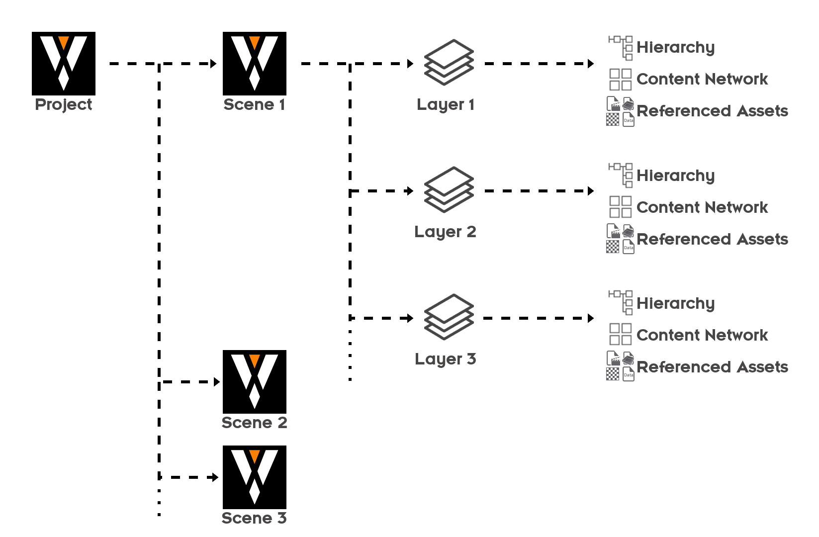

The graphic below illustrates the typical structure of a Ventuz project. Generally the Project consists of several Scenes that again consist of several Layers, be it 3D Layers or 2D Layers. Layers are a collection of Content Nodes and Bindings and - in the case of 3D Layers - Hierarchy Nodes. The Nodes are referencing any Assets needed by the logic of the scene.

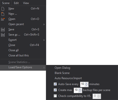

Ventuz provides a system to minimize the damage of unexpected application crashes and to keep track of scene file changes. To enable this system, open the Scene Menu and select the Load & Save category. There you find the AutoSave and the Create backup files option. The AutoSave mechanism will periodically save the current state of the open scene to the Scenes.revisions folder. The scene is saved under its current name with additional .auto extension.
The backup mechanism works as follows: every time a scene is saved (under the old name) by the user, a copy of the old scene version on disk is saved to the Scenes.revisions folder with an additional extension ####.bak. #### represents a number between 0000 and 9999. This number is incremented with every new save operation. If the maximum number of backup files is reached (as configured in the Load & Save Options) the oldest backup file (with the lowest index number) is deleted before a new backup file is created.
To open one of the Backup files or the AutoSave file open the Open Scene dialog and choose the desired scene version in the Revision drop-down box at the bottom of the dialog. Note that if such a backup scene is saved in the Designer, it is saved under its original name in the Scene folder - this does not overwrite the backup file!
Ventuz scenes themselves are generally not very large, even with a large number of nodes. Because the backup files do not need to include the assets, but only the scene itself, it is possible to have a significant number of automatic backups without using too much hard disk space.
