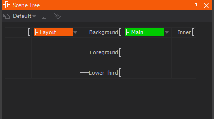

A Port can be locked. This means Remoting or the Scene Tree Editor are not able to change the scene-to-port assignment. One can either lock a port by checking its Lock property or simply bind the File property to a data source (e.g. URL node or Excel). Every Scene can have an unlimited number of Scene Ports to host sub-scenes. The level of nesting is called the Scene Level. The scene level one usually works with is Level 1, the next lower level is Level 2 and so forth. Layout Scenes work at Level 0!
Check the Scene Tree Editor to understand how the scenes are connected.
Every Scene Port has a name (the normal node name) and an Ordinal number starting at zero. This number is used to address Ports within a scene via Remoting. It is also important for Layout Scenes. The ordinal number can be changed via the node context menu in the Hierarchy Editor or the buttons at the bottom of the Property Editor. A scene assigned to a Port can be opened and edited on-the-fly without the need to reload it into its current scene ports. A scene-to-scene communication can be realized via the Interfacing mechanism as will be discussed later.
