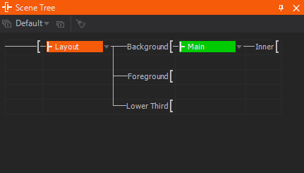

When working with nested scenes and remoting, one can easily lose one's overview of which scene is rendered where. That is why Ventuz provides the Scene Tree (SHIFT-F12):
This editor shows all scenes in memory along with their available ports. Scenes can be loaded by Ventuz Designer, by a Port node or by Remoting. The editor uses a tree-like visualization similar to that used in the Hierarchy Editor. Drag&Drop makes it easy to assign scenes to Ports and track assignment changes via Remoting. The scenes currently opened in the Designer as well as the current Layout scene are visually marked in the Scene Tree Editor. The screen-shot above shows following situation:
  • The Layout scene 'Layout' has 3 Scene ports: Background, Foreground, Lower Third.
  • The Port 'Background' is selected as the Port where new scenes are assigned to (bold font).
  • Scene 'Main' is assigned to Port 'Background' and is active/rendered in this Port.
  • Scene 'Main' contains another Scene Port ('Inner') which has loaded the scene 'Inner'.
  • Scene 'Layout' is the active document in the Designer so it is marked orange
  • Scene 'Main' is part of the rendered tree and therefore marked in green

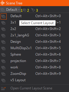

  • (1) Inside the Scene Tree Editor one can switch the Layout to be used by the current project (see Layout Scenes below)
  • (2) as well as open the currently used Layout scene for further editing inside the Designer.
  • (3) When you work with Remoting all unused Scenes loaded by Remoting can be released.
