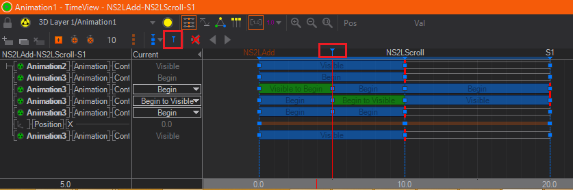

The Ventuz Template Engine extends the capabilities of the AnimationState Logic to make it more suitable for certain kinds of applications. As the name indicates, it is built for creating graphical templates which can be easily populated with dynamic data and/or customized on the fly. Examples for this could be slide-show style presentations or broadcast on-air graphics.
There are a number of functionalities that are combined in the Template Engine:
Auto-routing between states
Ventuz can automatically perform pathfinding inside the State Engine to find a path to a given state. So rather then performing a chain of trigger events, all one needs to do is tell Ventuz which template to arrive at and the pathfinding will figure out how to get there. This also is possible between multiple templates, animation nodes or even scenes. Essentially it allows for Ventuz to find a transition between any two templates without the need for complex transition tables.

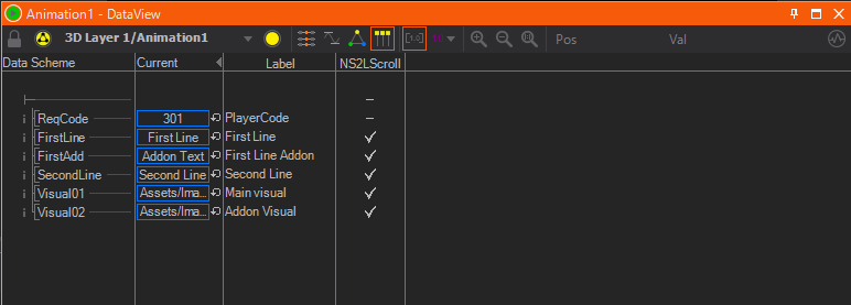

The data model can be created and accessed via the Data View of the animation editor window. As we saw above, this is also where Subtemplates are added and controlled.
To add a data item, simply drag and drop the property to be controlled as animation data into the animation data panel. It will be added in a similar fashion to a scene data or project data element, except that each data element can be associated or disassociated with any of the templates of that animation node. The data panel lists all of the data items for the templates in an animation node and a column layout allowing for every item to be checked or unchecked for each template. By checking the item, the data will be associated with that template. Thus it is possible to have quite complex data models where some data items are shared between templates and others are not.
Each element should be given a unique name, and by clicking on it, you can also edit, in the properties panel, settings such as default value, allowable minimum and maximum values, a label for operator identification, or a description. Remember that as soon as you set up a data channel, any local value you had set will be overridden by the animation data, so it is worth setting up a default value first.
An important key to transitions is the exact point when this data, associated with a template, is passed to the animation node. So, for example, if a self-to-self transition is called, but the data changes, perhaps an animation is desired where the data is changed at a specific moment, but the actual template changes very little. The exact transfer point for the data can be defined in the timeline by positioning a data marker. To place this marker, enter the animation editor window and position the timeline at the point where the data should be transferred, then press M. It will add a small marker at the top of the animation timeline. This marker can be moved, as its properties edited by dragging or selecting it. Multiple markers are allowable, in which case data will be updated on the first marker that is passed and subsequent markers ignored unless the data has changed.

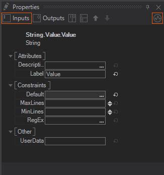

Data Items Meta Data
All Data Items are described by meta data that can be edited in the Property Editor after  clicking it. For example the Ventuz Director uses them to display Template and Project Data properly for the operator of the program. In Remoting you can use the Data Model's Meta Data to accomplish similar results. Below you can see how Ventuz handles these meta data.
General Properties
Besides the Ventuz specific meta data you can define your own data using the UserData property. This is not used by Ventuz anywhere and you can safely use it for information specific to your own application.
Each type of the Data Channels has a Label property that defines the user friendly display name of the channel. As opposed to the data channel names, labels can consist of special characters, e.g. spaces. In addition they are not used to identify a channel, so the data model can have duplicate labels. Similar to the label, the Description is used to present further information to the user - e.g. in the Ventuz Director this is displayed while hovering over the data item.
Format is somewhat specific to the Ventuz Director and its template based workflow - when creating a Page from a template you can decide to automatically create the page's display name and/or description from the current values of the template data. The format property defines what to use from each data item for the automatic naming. The table below shows the possible options - the dropdown of the property also displays some presets that you can choose from.
Data Types Value Effect
all empty string Not used in the automatic naming.
!X Shows the value of this data item in the display name of the page instead of in its description.
float, double fX Fixed point number with X decimals. X defaults to 2.
cX Currency with X decimals. X defaults to 2.
eX Exponential notation with X decimals. X defaults to 6.
nX Number with X decimals. X} defaults to 6.
p Percentage. Note that the displayed number is therefore multiplied by 100.
integer dX Integer number with minimum X digits. X defaults to 1.
xX Hexadecimal number with minimum X digits. X defaults to 1.
boolean X;Y X if true, else Y.
string, enumeration X Show string truncated to X characters. Do not truncate if 0.
-X Show string truncated to X characters and show elipsis for truncated characters.
color c Known color name or expressed as Red, Green, Blue values.
# Hexadecimal string.
array 0 "X" Show number of values followed by X
csv Show values as comma separated list.
asset nx File name with extension.
n File name without extension.
uri Full file path.
In the above descriptions, X and Y are wildcards.
Constraints
Each different type of data channels has a set of Constraints guiding the user when setting values on these items. Below is a list of all constraint properties and their functions in Ventuz.
Data Types Property Usage
all Default The initial value of the data item.
float, double, integer Max Maximum possible value. Value will be set to Max if it is greater.
Min Minimum possible value. Value will be set to Min if it is less.
Speed Change speed when using drag and slide to change the value.
string Choices You can add a comma seperated list of values to change the text box to a combo box, so that the user can choose from predefined values as well as type a custom text.
MaxLines Maximum number of lines. Will be truncated to this number of lines if it is exceeded.
MinLines Minimum number of lines. Will be truncated to this number of lines if it is underrun.
RegEx A regular expression that the given text is tested against so that only input of a certain form is allowed. If it does not match the text cannot be set.
color Alpha Whether alpha can be defined as well or not.
enumeration Elements Comma separated list of elements that the user can choose from. Note that Default must be present in this list.
array MaxLength Maximum allowed number of values in the array.
MinLength Minimum allowed number of values in the array.
asset AssetPools The allowed asset pool to choose from. All assets that are not associated with any of the chosen pools will be ignored. Misc allows any type of file. This also filters the list of assets in the shotbox of the Ventuz Director when it was opened by  clicking on the asset channel.
Required If set it disallows to leave this data item empty.
