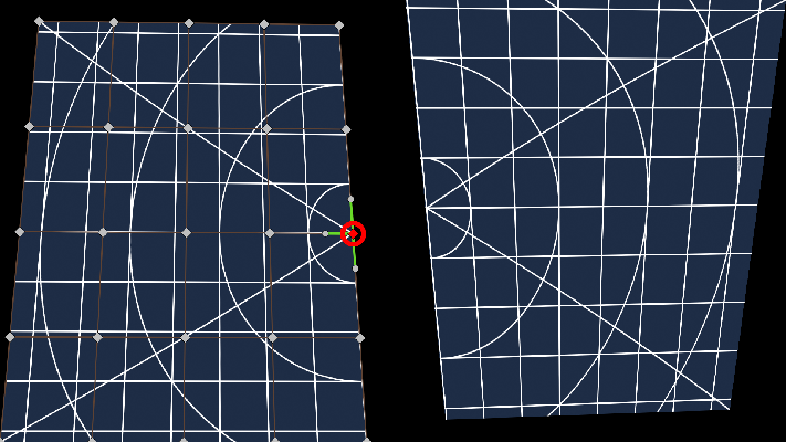

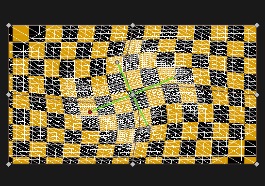

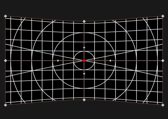

Warping is done by defining a grid. By default, a 2x2, 3x3 and 5x5 grid are automatically created, called Layers. All layers together are called a Group. It is possible to add additional layers if more control is required, or to add new rows and columns to an existing layer.
The finest layer will be used to create a mesh that does the actual distortion. The coarser layers are used to modify the finer layers. It is possible to switch freely between the layers and do coarse corrections even after fine-tuning was done without losing work done on any other layers.
When rendering a mesh, the texture is linearly interpolated, while the control grid uses Bézier splines to interpolate. So it is not good enough to just use the finest layer as base for warping, within Ventuz adaptive tesselation is applied until the error is below a certain threshold.

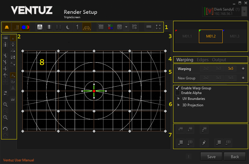

The User Interface
Here a general overview of the user interface:

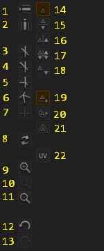

  1. Toolbar for global tools
  2. Toolbar with control-point related tools (side-bar)
  3. Output (projector or other display) navigation
  4. Switch between output settings, warping and soft-edging
  5. Group and layer navigation
  6. Group and layer related properties
  7. Toolbar with group and layer related tools
  8. Grid Editor
Many operations have keyboard shortcuts, so most of the work can be done without looking at the user interface on your computer monitor, but at the outputs directly.
The output navigation (3) displays a schematic view of the outputs. It will not try to faithfully represent the actual size and position of the displays but indicates the general layout, like a subway map will not represent the actual distance between stations. For instance, overlap is not shown here.
To change the current output, either click or click and drag in this area or use cursor + alt keys to change the current output.
The area marked with (4) can be used to switch between warping and soft-edging. The output section contains color correction and other per-output settings.
The group and layer navigation allows to jump between groups and layers. Here are examples of two edging groups with one layer each, and a warping group with 3 layers.
With the keyboard, pressing 'W' or 'E' will cycle through the warp or soft-edge groups. Page up and down walk through the layers of the current group. The home key goes to the coarsest layer and the end key goes to the finest layer.
If you have multiple groups, SHIFT + Page Up / Down will select groups and ALT + Page Up / Down will move the current group up or down.

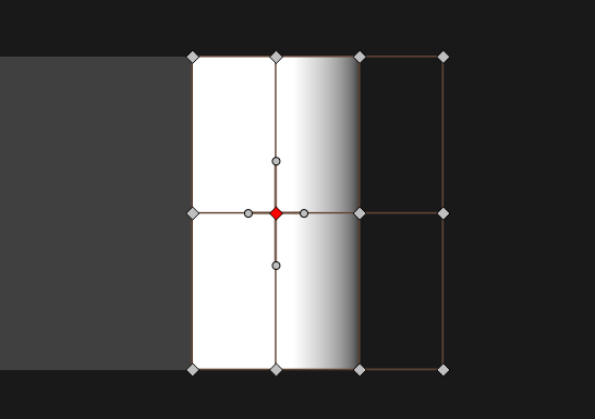

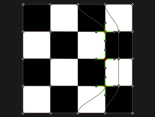

In addition to the primary control points at the cross-sections of the grid, there are control handles for finer control over the mesh. These are only visible, and can only be clicked on when the associated primary control point is selected.
When working with the keyboard, using the cursor keys will move the cursor, and the cursor is also selected. Pressing 'b' will enter box-selection mode, again use the cursor to change the box size. To move the cursor to a control handle, use cursor keys + CTRL.

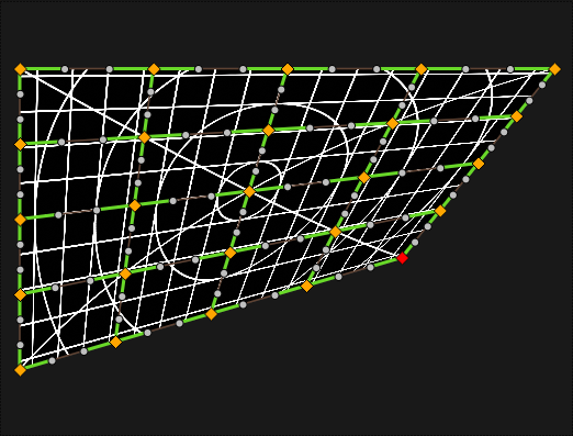

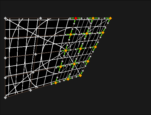

Smart Mode
Smart Mode is good to edit a rectangular selection of vertices. It is done by first making a selection, and then pressing SHIFT and ALT while moving control points either with mouse or cursor keys.
If corner or edge control points are moved, all selected control points will move along, in a proportional manner:
Here we have selected all control points and move the lower-right corner:
Now we select the right half of control points and move the edge towards the middle:

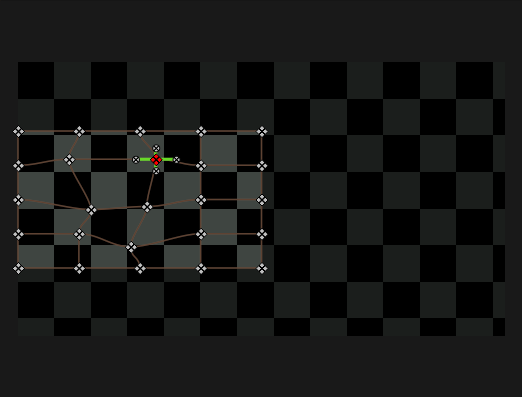

Smart Mode is best explained with rectangular selections, but it will work with selections of any shape. The definition of what is an edge or a corner depends on the limits or bounding box of the selection. With a selection containing no corners, smart mode is of limited value.

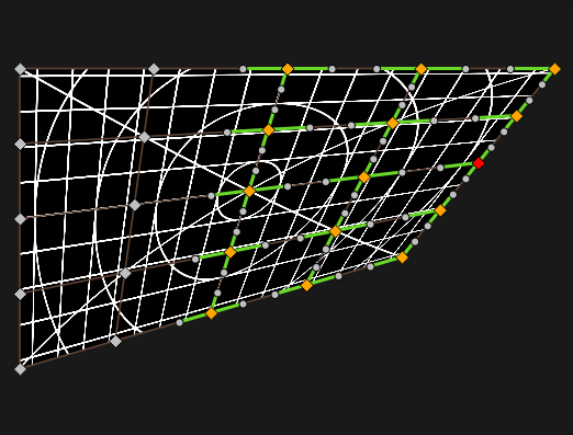

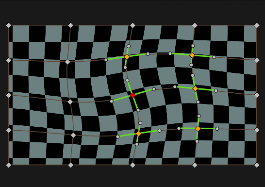

UV Editor
By default, the control points are mapped to evenly spaced locations of the content (or test image). So if you have a 5x5 grid and your test pattern is a 4x4 checkerboard, each control-point is directly bound to one of the intersections:
By pressing SHIFT U or using the toolbar, the UV-Editor-Mode can be entered or left. Control points and cursor are painted with a hashed pattern so that it is easy to notice if this mode is on or not. UV editing is only available for the finest layer of a warp group. It will deactivate when switching to edge groups or any other layer than the finest.
In UV mode, we see the unwarped content and can change what part of the content the control point is bound to:
Switching back to the normal mode, we see how the image is warped although the control points stay at their default position.
This can be combined with multiple warp groups and the UV Boundaries that can be set for each warp group to create complex projection mapping.
All control point editing features are available in the UV-Editor. For instance, one could select all control points and use the rotate and scale mode or smart editing to position them quickly and cleanly.

The Side-Toolbar

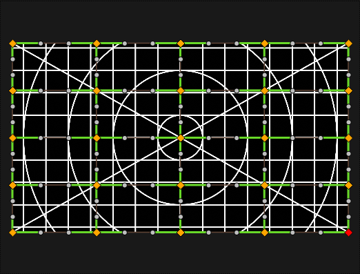

At the very left of the editor is a toolbar with buttons that help edit the grid.
Nr. Keyboard / Mouse Descriptions
1 Insert row (right of cursor)
2 Insert columns (below cursor)
3-7 A U K L S Handle Modes, see below
8 X Reset selected points to default position
9  wheel up Zoom in
10 R Reset zoom and pan
11  wheel down Zoom out
12 CTRL-Z Undo
13 CTRL-SHIFT-Z or CTRL-Y Redo
14 cycle with O, SHIFT O Mirror Mode off
15 cycle with O Mirror Mode Horizontal
16 cycle with O Mirror Mode Vertical
17 cycle with O Mirror Mode Horizontal + Vertical
18 cycle with O Mirror Mode Point-Symmetry
19 Normal Control Point Movement (Translation)
20 Toggle with SHIFT S Scale
21 Toggle with SHIFT R Rotation
22 Toggle with SHIFT U UV Edit Mode
- ESCAPE Reset mirror, scale, rotate and multiselect

Zooming and Panning
The grid editor can be zoomed with the mouse wheel and panned by dragging around with the middle mouse button. There are also zoom buttons on the left toolbar. Press the R key to reset to default zoom & pan.
Handle Modes
The color of the handles indicates how the handles behave and which constraints they enforce.
Name Color Shortcut Description
Linked Green A Both sides have same direction and stretching
Straight Yellow U Both sides have same direction, but can be stretched differently
Unlinked Red K Both sides are completely independent, allowing for kinks and different stretching
Linear Pink L Handles are automatically calculated for linear interpolation
Default Brown S Handles are automatically calculated for maximum smoothness
With most modes, the change of a handle is local and affects only the area of the surrounding 3x3 control points. In default mode, the change affects a 5x5 surrounding. This mode is useful for the 2x2 and 3x3 layers where this does not matter.
To change the mode, select a handle and press one of the handle mode buttons. Alternatively, use the keyboard shortcuts in the table above. In both cases, when selecting a primary control point, both horizontal and vertical handle mode are set.
In default mode, the handles are calculated automatically. When trying to move a handle in default mode, it automatically switches to linked mode to allow editing.

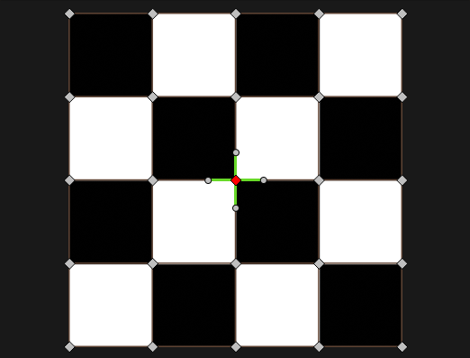

Subdivision
By pressing the '+' icon in the layer navigation, the finest layer can be subdivided in X, Y or both. This will insert a row and/or columns between every existing pair of rows/columns: a 5x5 point grid turns into a 9x9 point grid.
As 33x33 is the finest allowed layer, any layer with more than 17 points either horizontally or vertically can not be subdivided anymore.
Subdivision is the most precise way to add more control points, as all other methods are worse at capturing detail in the new, finer layer.
One could consider a 5x5 point grid is a 4x4 square grid, and every square gets sliced in half horizontally and vertically, resulting in an 8x8 square grid, or a 9x9 point grid.

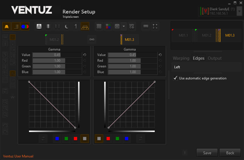

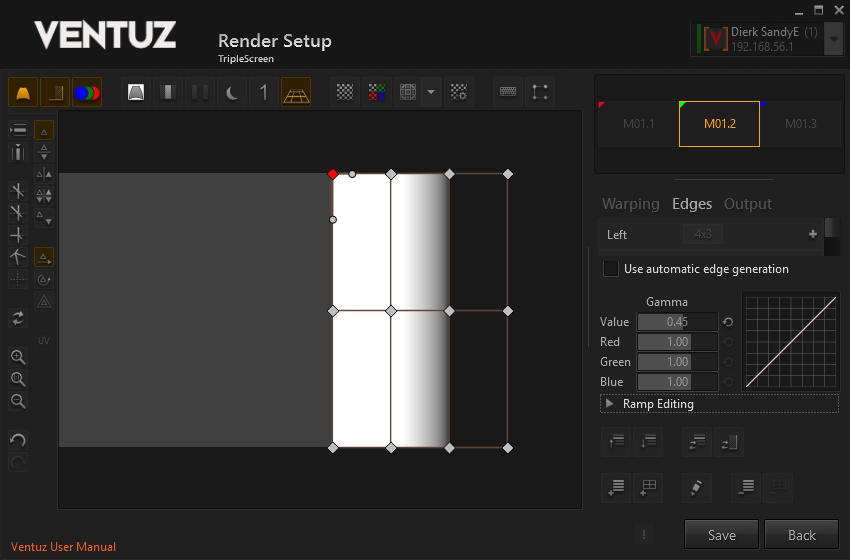

Soft-Edges
There are two modes for creating soft-edges. Automatic mode and manual mode. Automatic mode will be sufficient for projections on semi-planar surfaces. When doing 3d projection mapping, the soft edges might become very irregular, and manual mode might be required.
Automatic mode is enabled by default and can be disabled in the Edges section.

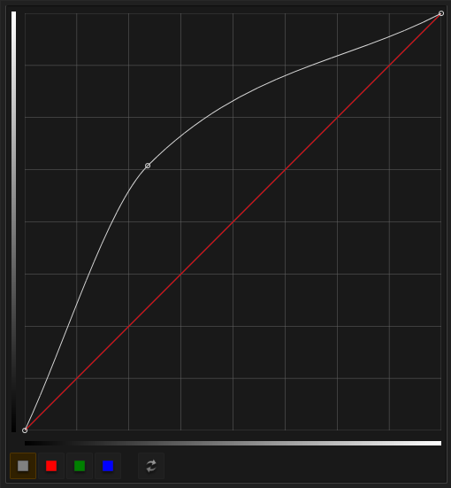

The gamma values
The ramps for soft-edging execute the following functions in this order:
  1. Apply the white spline
  2. Apply the separate red/green/blue splines
  3. Apply the gamma value
  4. Apply the separate red/green/blue gamma values
This allows you to roughly adjust the gamma, and then use the spline editor to fiddle with the ramp until it is satisfactory.
Each ramp (or group) has its own set of gammas and splines.
This is the same for automatic and manual mode, even though the user interface differs.
Spline control points are inserted by clicking on the spline itself. They can be moved by clicking on them and dragging them. Moving a control point next to another control point removes it.
The buttons below switch between the splines for white, red, green and blue, and revert the spline to default.
Automatic Mode
In automatic mode, the shape of the edges can not be changed. If the warping is correct, this should not be required.
The output navigation will show the edges. By clicking on an edge, an editor window will open up and allow to edit gamma sliders and splines of both adjacent edges.
Manual Mode
Here the geometry of the edges can be edited just like a warping layer. It is possible to add more control points to the grid. Remember that the edges are also warped, which can be a bit confusing when editing edge-layers on the projection screen.
In manual mode, only one edge can be edited at a time.
Each point has an associated value, which is either 1 (white, image) or 0 (black). If more complex forms than simple edges are required, this value can be edited with a slider among the properties or by pressing the I and shift-I keys, setting the value to 0 or 1.
The spline editor for the ramps is started by pressing on the small splines next to the gamma sliders. This opens a bigger window.

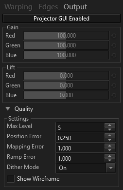

Per Output Settings
The output category has the following properties:
Color Correction
Name Description
Gain For color correction, a value that is used to multiply the rendering pixels
Lift For color correction, a value that is added to the rendering pixels, before contrast is applied
To change all 3 (red, green and blue) sliders at the same time, press the Alt key while dragging with the mouse. This will change the color values while trying to preserve the ratios between the colors, so brown will always stay brown and not become more and more pale-white as values increase.
Quality Settings
The Quality section mainly controls how fine the warping mesh is to be tessellated. The defaults are set for quite high quality, when using more precise values you should check for wasteful over-tesselation with the Show Wireframe option.
Name Description
Max Level Maximum subdivision when creating the mesh from the finest layer
Position Error Acceptable difference for the vertex positions between perfect Beziér interpolation and the actual mesh, in pixels
Mapping Error Acceptable difference for the UV mapping between perfect Beziér interpolation and the actual mesh, in pixels
Ramp Error Acceptable difference for ramp colors between perfect Beziér interpolation and the actual mesh, in color values ranging from 0 to 255
Dither Mode Enable dithering to improve ramp quality. Temporal dithering will change the dither pattern every frame, that usually gives better results but may result in undesirable artifacts.
Show Wireframe Shows the wireframe of the warping mesh. Useful for checking if the level of subdivision is reasonable or insane.
Enable / Disable Projector User Interface
When working with large or complex render setups, one might want to continue warping at one portion of the installation while another portion already operates.
The Projector Gui Enable button allows excluding some of the outputs from being affected by the shaping editor. Warping, Shaping and Masking are done as edited, but test patterns and the user interface is never drawn. The affected outputs are crossed out in the navigation.

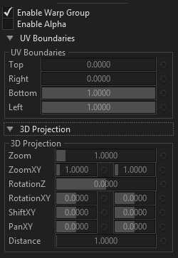

Enable Warp Group / Alpha Blending
These options are especially useful when working with multiple warp groups on the same output.
Enable Warp Group is on by default. This allows to temporarily disable a warp group.
Enable Alpha This allows to use alpha blending when warp groups overlap. Since the alpha channel often contains garbage, this is disabled by default
UV Boundaries
This allows making a warp group use only a portion of the content. Numerical input is possible for entering precise values.
This is useful when using multiple warp groups.
The same effect can be achieved with the UV Editor. This is more convenient for moving the whole UV selection, while the UV Editor allows irregular warpings. Both methods can be combined.

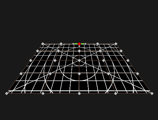

3D projection
With these values set to default, the warping mesh is rendered straight on the screen, with no distortion.
3D projection allows a virtual camera to move around the warping mesh to get perspective correct projection.
All fields allow for precise numerical input.
Rotation will orbit the camera around the warp mesh.
Zoom will change the field of view.
Distance works like a vertigo slider: at the same time the distance is changed, the zoom is changed the other way around to preserve the size of the warp mesh. This will either exaggerate or minimize the effect of the perspective distortion.
Shift this will move the warp mesh around, while the camera stands still. Pan this will move the final image around, with no change in perspective.
Shift will move the warp mesh
Press ALT R to reset the 3D-Projection.
